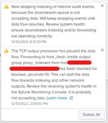

Not ruling out misconfiguration to be honest, its becoming a bit of a minefield! If i log into the onprem deployment server, i can see the endpoints we have installed the UF on. So we are getting from the endpoint to the onprem servers fine. I dont see any further errors in the deployment server. I do see them in the heavy forwarder console, as such:
PickleRick
Your warnings tell you that indeed the forwarding is not happening. To find out why you need to look into /opt/splunk/var/log/splunk/splunkd.log
The Deployment Server<->Deployment Clients (UFs) communication is something completely different than forwarding events to outputs so in case of diagnosing the outputs it won't help.
