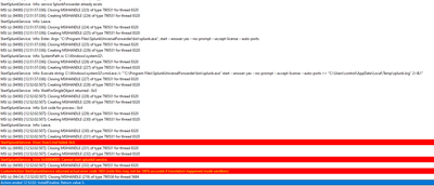

I've installed the forwarded on several other domain controllers in our environment but these last 2 keep failing, throwing the all too enigmatic "setup ended prematurely" error.  "Like a F-18 bro!"
They are Windows Server 2019
9.0 forwarder 64-bit installer
Regardless that the log states "SplunkForwarder already exists"; there is no current installation of the forwarder (but I have attempted it several times)
The logs don't seem to have any intel I find useful, but maybe you all have a better secret decoder ring?
msiexec.log:
splunk.log:
Other than a few of these types of details "input type=perfmon because it already exists" still unsure of the problem:

jvcog
New Member
Thanks for the follow up.  I have checked and there are no indications of lingering installations.  However, I imagine there must be something in the registry that is flagging the installer but I will not haphazardly remove any "splunk" mentions from my Domain Controller registry until Splunk indicates exactly which HKEY paths to check and are safe to delete.  Do you have any suggestions of registry keys and or folders that need to be removed before proceeding with a new attempt to install?  Should I just open a support ticket and have official support address this issue?
