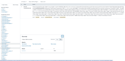

I am having some big issues trying to parse certain XML logs into Splunk.
A sample online log which is in the same format as what I see in Splunk _raw logs are as below:
<Event><System><Provider Name="Linux-Sysmon" Guid="{ff032593-a8d3-4f13-****-*******}"/><EventID>3</EventID><Version>5</Version><Level>4</Level><Task>3</Task><Opcode>0</Opcode><Keywords>0x8000000000000000</Keywords><TimeCreated SystemTime="2023-11-13T13:34:45.693615000Z"/><EventRecordID>140108</EventRecordID><Correlation/><Execution ProcessID="24493" ThreadID="24493"/><Channel>Linux-Sysmon/Operational</Channel><Computer>computername</Computer><Security UserId="0"/></System><EventData><Data Name="RuleName">-</Data><Data Name="UtcTime">2023-11-13 13:34:45.697</Data><Data Name="ProcessGuid">{ba131d2e-2a52-6550-285f-207366550000}</Data><Data Name="ProcessId">64284</Data><Data Name="Image">/opt/splunkforwarder/bin/splunkd</Data><Data Name="User">root</Data><Data Name="Protocol">tcp</Data><Data Name="Initiated">true</Data><Data Name="SourceIsIpv6">false</Data><Data Name="SourceIp">x.x.x.x</Data><Data Name="SourceHostname">-</Data><Data Name="SourcePort">60164</Data><Data Name="SourcePortName">-</Data><Data Name="DestinationIsIpv6">false</Data><Data Name="DestinationIp">x.x.x.x</Data><Data Name="DestinationHostname">-</Data><Data Name="DestinationPort">8089</Data><Data Name="DestinationPortName">-</Data></EventData></Event>

For some reason, the computer field is extracted successfully but not eventID or data name fields.
I have also tested the regex in regex.101 but not working.
I am not sure if it's the raw logs having issues or something else?

I am using the sysmon for linux add-on and the fields are not extracting besides Computer and Keywords.
https://docs.splunk.com/Documentation/AddOns/released/NixSysmon/About
I just can't figure out what I am doing wrong because I can see the logs besides those.
