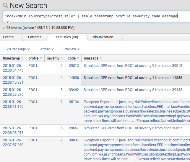

emiller42
Motivator
Another option is to use an EXTRACT instead of DELIMS+FIELDS.
Here is how I would approach the props.conf entry:
[gpp_error_log]
SHOULD_LINEMERGE=false
LINE_BREAKER=([\r\n]+)(?=####)
MAX_TIMESTAMP_LOOKAHEAD = 23
TIME_PREFIX=^####
TIME_FORMAT=%F %T.%3N
EXTRACT-gpp_fields=^####(?<timestamp>[^,]+),(?<profile>[^,]+),(?<severity>[^,]+),(?<code>[^,]+),(?<message>.+)$
Produces the following:
