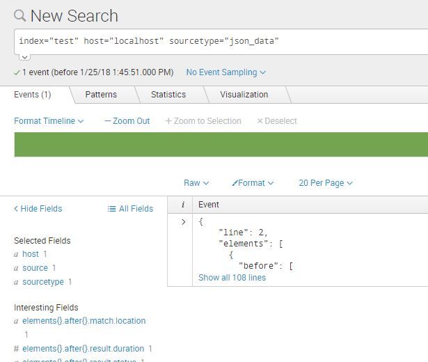

Howevere splunk is only showing the first 108 lines from the file and not the whole
The SPL I used is -
index="test" host="localhost" sourcetype="json_data"
The location json file is on the indexer as well as on the forwarder. but nothing works.

and what splunk displays -
Can someone please help.
If you need any other info please comment.
mdsnmss
Based on your sample JSON I think the issue is with your linebreaking. Your configuration is to linebreak after "]". There are those brackets within the inside of your event already so that isn't something that necessarily dictates being the end of the event. Is there a definitive pattern that shows up near the end of your event every time? Or is this just a single JSON event you are trying to ingest? If it is just a single event you can likely leave MUST_BREAK_AFTER empty as it defaults to empty.
mdsnmss
You may also want some timestamping settings included as well. TIME_PREFIX, MAX_TIMESTAMP_LOOKAHEAD, and TIME_FORMAT may be something that is useful to set. Please let me know if you have any questions on these!
sdawsonkg
initially I kept the MUST_BREAK_AFTER as blank. Still it did not show the full data.
