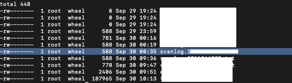

The logs are related with an Antivirus (policies, detected viruses and so on), in the first image you can see the file was created at 00:35:00 , this is an Antivirus Scan

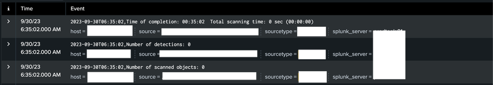

Finally this is an image of the Splunk search, the _time column is aligned with the timestamp with the log content 
The register was supposed to arrive at 00:35, but was entered at 06:35. (6 hours after the scan)
