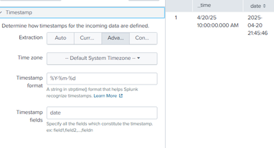

I have a Json file which contains a "date" field. The date field in my data that can either be of format %Y-%m-%d %H:%M:%S (e.g. 2025-05-23 9:35:35 PM) or %Y-%m-%d (e.g. 2025-05-23). The only way to ingest this Json is via manual ingestion.
When trying to set the _time field on ingest, setting the timestamp format to %Y-%m-%d %H:%M:%S will fail and default to the wrong _time value for date fields with format %Y-%m-%d. However, setting timestamp to format %Y-%m-%d won't capture the HMS part. Was there a way to coalesce these so that it will check if HMS is present, and if so, then apply %Y-%m-%d %H:%M:%S format? Or is there a workaround so at least the data ingestion for _time is accurate?

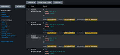

kiran_panchavat
@cherrypick
Then you can try this
props.conf
[json_splunk]
SHOULD_LINEMERGE = false
LINE_BREAKER = ([\r\n]+)
TIME_PREFIX = "date":\s*"
TIME_FORMAT = %Y-%m-%d %I:%M:%S %p
MAX_TIMESTAMP_LOOKAHEAD = 60
TRANSFORMS-normalize = fix_date_field, fix_time_hour
transforms.conf
[fix_date_field]
REGEX = ("date":\s*")(\d{4}-\d{2}-\d{2}|\d{2}-\d{2}-\d{2})(")
FORMAT = $1$2 12:00:00 AM$3
DEST_KEY = _raw
[fix_time_hour]
REGEX = ("date":\s*".*?\s)(\d{1})(:\d{2}:\d{2}\s(?:AM|PM))
FORMAT = $10$2$3
DEST_KEY = _raw
output:
Sample events which i tried:
{"date": "2025-05-23 9:35:35 PM", "event": "Login"}
{"date": "2025-05-23", "event": "Logout"}
{"date": "2025-05-24 10:15:00 AM", "event": "Login"}
{"date": "2025-05-24", "event": "Logout"}
{"date": "2025-05-25 11:45:00 AM", "event": "Update"}
{"date": "2025-05-25", "event": "Login"}
{"date": "2025-05-26 12:00:00 PM", "event": "Logout"}
{"date": "2025-05-26", "event": "Update"}
{"date": "2025-05-27 1:30:00 PM", "event": "Login"}
{"date": "2025-05-27", "event": "Logout"}
Did this help? If yes, please consider giving kudos, marking it as the solution, or commenting for clarification — your feedback keeps the community going!

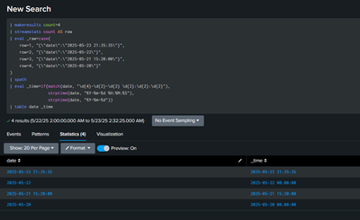

| makeresults count=4
| streamstats count AS row
| eval _raw=case(
row=1, "{\"date\":\"2025-05-23 21:35:35\"}",
row=2, "{\"date\":\"2025-05-22\"}",
row=3, "{\"date\":\"2025-05-21 15:20:00\"}",
row=4, "{\"date\":\"2025-05-20\"}"
| spath
| eval _time=if(match(date, "\d{4}-\d{2}-\d{2} \d{2}:\d{2}:\d{2}"),
strptime(date, "%Y-%m-%d %H:%M:%S"),
strptime(date, "%Y-%m-%d"))
| table date _time
