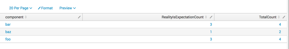

OK I think I get it now.
See if the following sample I tested on my lab works for you:
| makeresults
| eval events = "
{\"tests\": [
      \"expectation\": \"true\",
      \"reality\":\"true\",
      \"test_statistics\": {
        \"components\": \"foo, bar\"
      \"reality\": \"false\",
        \"components\": \"foo, bar, baz\"
{\"tests\": [
      \"reality\": \"true\",
| eval events = split(events, "||")
| mvexpand events
| spath input=events path=tests{} output=tests
| mvexpand tests
| spath input=tests
| rename "test_statistics.components" as component
| makemv delim="," component
| mvexpand component
| stats count(eval(match(expectation, reality))) as RealityIsExpectationCount, count as TotalCount by component
This would be the output which I understand it is exactly what you were expecting:
