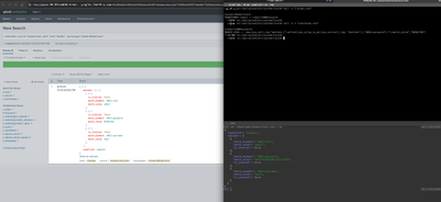

As this is JSON ive written an alternative INGEST_EVAL for this which relies less on replacing parts of the raw json string and uses the JSON functions instead, let me know if this helps!
In the screenshot you can see the raw data added (bottom right) the props/transforms (top right) and output (left).
# props.conf
[yourSourceType]
TRANSFORMS-redactJSONPassword = redactJSONPassword
# transforms.conf
[redactJSONPassword]
INGEST_EVAL = _raw=json_set(_raw,"matches.{".mvfind(json_array_to_mv(json_extract(_raw, "matches")),"ARGS:password")."}.match_value","REDACTED")
PickleRick
