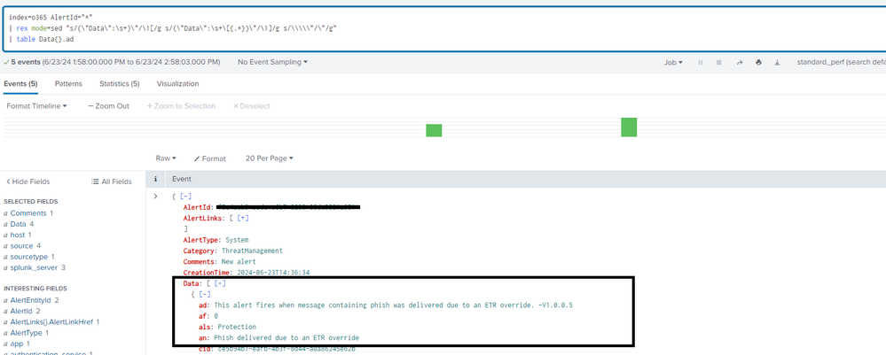

2. From UI using the below worked to some extent. Data string to list [ { } ]
| rex mode=sed "s/(\"Data\":\s+)\"/\1[/g s/(\"Data\":\s+\[{.*})\"/\1]/g s/\\\\\"/\"/g"
Issue now is it is not automatically identifying the key value pairs inside the Data Dictionary, irrespective of the setting kv_mode =json.
