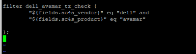

So the issue was with Dell Avamar specifically, so I did the following in compliance_meta_by_source.conf:
And the following in compliance_meta_by_source.csv:
