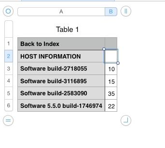

The biggest issue I see with this file is that it's poorly formatted and not truly a well-formatted CSV file. See the screenshot below of when I saved the sample text you sent, saved it as software_summary.csv and opened it in Numbers on my mac.
If you did have it as a CSV then your props.conf would also include INDEXED_EXTRACTIONS = CSV and would handle this file much easier.
