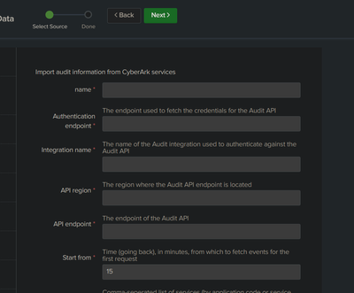

@vh
I’ve set up this add-on in my lab environment and can see the data input option listed below. Could you please take a look and confirm?
Navigate to Settings > Data Inputs.
Multiple CyberArk data inputs.

PickleRick
I have no idea what they mean by "certificate" and "private key" since the fields are just text fields (and neither splunkbase page nor Cyberark's docs help here). But when you type anything in and click save, you'll get to the "add input" dialog, where you can type in stuff like API endpoint or region.
