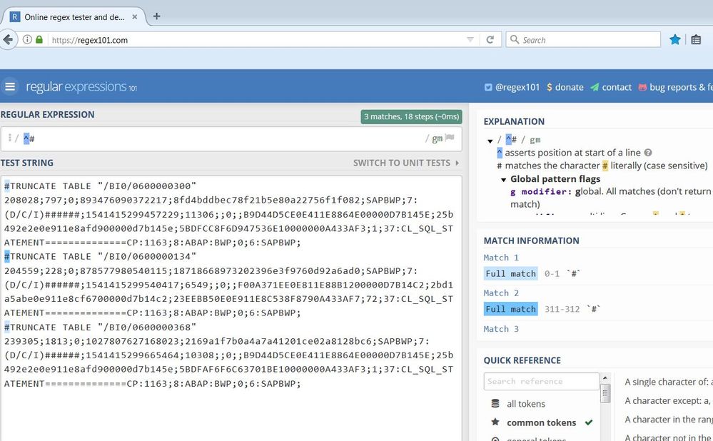

ddrillic
Ultra Champion
Please try -
[<your sourcetype>]
disabled=false
LINE_BREAKER=^#
SHOULD_LINEMERGE=false
