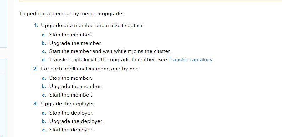

Looking at the upgrade procedure and it says at Upgrade a search head cluster
I would assume the sequence to be quite the same.
In the Cluster Administration it was said however -
-- The captain is the final member to restart (during a rolling-restart) and automatically invokes captaincy transfer, thus preventing captaincy from changing during the restart process.
That's exactly what @masonmorales just said.
