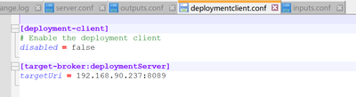

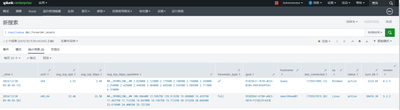

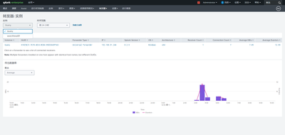

I encountered an issue, as shown in the image. I can see two machines in the MC's forwarder dashboard, but I don't see any machines in my forwarder management.
I have added the following configuration to DS, but it still doesn't work after restarting

Then, did you checked if firewall route between UF and DS is open for the Management Port 8089 used by the DS ?
You can check it from the UF using telnet:
telnet 192.168.90.237 8089
Then, on the UF, I suppose that you configured outputs.conf in $SPLUNK_HOME/etc/system/local, is it true?
it's a best practice do not configure outputs.conf in $SPLUNK_HOME/etc/system/local, but in a dedicated add-on deployed using the DS.

I found the problem, I needed to add the following to the inputs.conf file of UF, I don't know if this is a problem after the update or if it was also needed before, obviously when I typed it they showed
[default]
host = 192.168.90.233

Do you have look from internal logs (_internal and those _ds*) if there are any hints why those are not seen on DS's screens?
