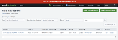

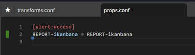

zksvc
Contributor
When i check in props.conf it only call REPORT-ikanbana without specific about the fields.
same as if i check in UI there is no configuration for specified fields
