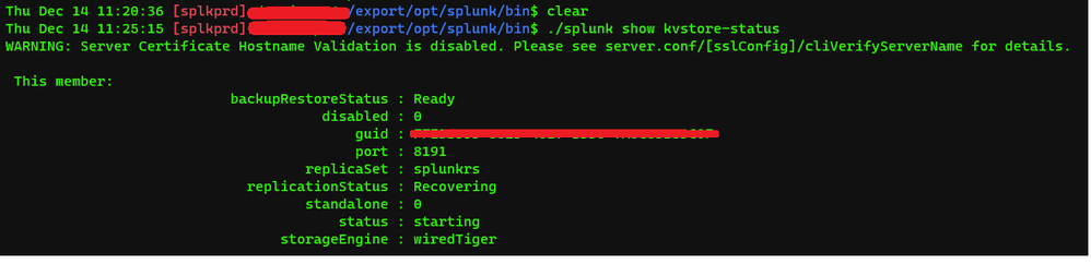

Thank you for the response. The more I read about the backups, the more worried I get.
Did you backup the entire KV store or just a specific collection? I would like to clean the entire store on two servers.
In the Splunk Docs, for the KV store backup, it says
  1. Ensure that the backupRestoreStatus field and the status field are both in the ready state.
Our backupRestoreStatus is ready, but our status on each of the Failing servers is starting
Both of the servers look like that. I think you resync'd the entire cluster. Have you had to resync individual servers? And I do not want to move to any other SHC, these two are staying where they are.
