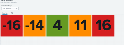

use colorpallette to change color of extremes on a dashboard
dolj
I am trying to change the color of a result based on its deviation from zero. the numbers can be both positive and negative. The range I am trying to implement is as follows,
(-10) <- 0 -> 10 should be #ff0000
(-15) <- (-10) and 10->15 should be #ff8c00
<- (-15) and 15-> should be #ff0000
basically any result from 0 to plus/minus 10 should be green, anything between plus/minus 10 and plus/minus15 should be orange and anything past plus/minus 15 should be red.
Is this possible?

livehybrid
Hi @dolj
Is this what you are after?
I have included the dashboard content below for you to work with and update

Please let me know how you get on and consider adding karma to this or any other answer if it has helped.
