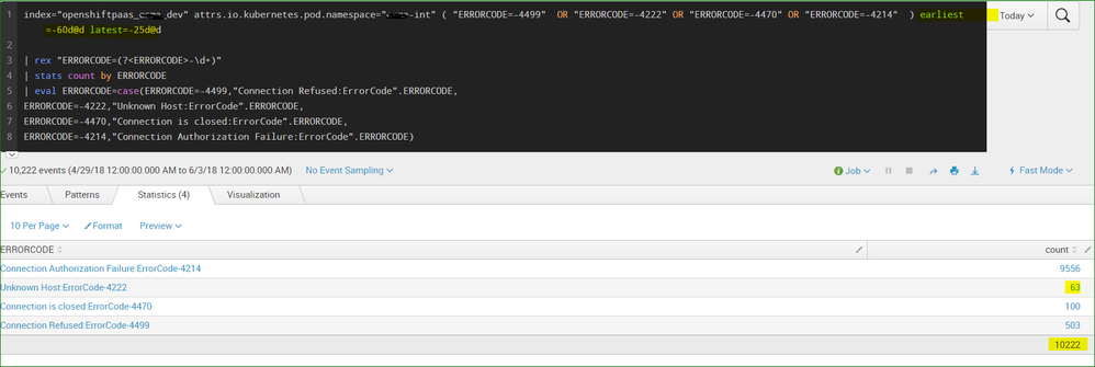

I've created a dashboard with some panels, and I am getting different event counts than when I run the reports individually. The event counts from dashboards is less than the event counts run through a report. I've read some posts mentioning that we can do some settings in savesearches.conf file to run the dashboard in verbose mode. I have Splunk User role access, and I don't have admin access to perform these changes. Please suggest if there is a way to get this resolved through Simple/Advance XML dashboard configuration.
snayani
Please let me know if you can see the 'Verbose' image.
snayani
Fast mode events count: 10222

The only difference is not only field discovery but the count of events also differ. If I run the dashboard panel as a report in fast mode, the events count is same when I run the report from a dashboard. There is mismatch of results while running the search from dashboard from the search ran from report or a general verbose mode search.

I ran the searches in verbose and fast mode. I took screenshots, to show the differences of events I am seeing when I run the search in fast mode versus verbose mode. But I am unable to post the screenshots here. You can try to see the difference by running simple query with a transforming command in it.

I tried the method you mentioned above. Please find screenshot below. The count is 10,222 in fast mode and the count is 10,600 with verbose mode.

Pos the image with identical SPL in verbose mode
snayani
Please find the second image in answer section.
skoelpin
Image looks broken
snayani
Could please try opening the browser in chrome?
skoelpin
I'm using Chrome.. First image shows and second image is broken. Please get this straightened out before replying back
snayani
Please see below, for the Verbose image, I've uploade. Please let me know if you can see without any issue.
