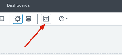

Its worth viewing the dashboard source
And look for the "layout" section,
Do you have a "layoutDefinitions" with "layout_1" and then a "type" containing a value?
Similar to this?
