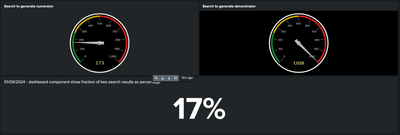

 POC on local instance:

But just going off your initial post, Two searches feeding two radial gauges using a "| stats count" to transforms the searches into a single value in a field named "count".
I would use a done tag in the XML to set the resulting field "count" value of search1 to a token named "Numerator" and another done tag for search2 to set resulting field "count" value to token "Denominator".
With these two tokens set based on the results of the two searches, they can be used elsewhere on the dashboard, including getting injected into an eval expression directly after a generating command "| makeresults"
Here is an example of this methodology used here.
And a snippet of XML used to do this. Obviously you would need to put your own searches into the radial gauge panels.

 The reason for showing you this is to demonstrate setting tokens based on results of another search by use of the "<done>" and "<set>" tags.
Anytime you have a single result in the final output of a search on a dashboard, your should be able to tokenize this value by using these (<done>|<progress>)(<condition>)?(<set>|<eval>) and referencing
$result.<fieldname>$ where <fieldname> is the fieldname of the valiue you are trying to tokenize from the search.
