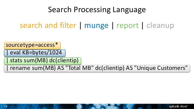

Official SplunkFu (http://image.slidesharecdn.com/splunkninjas-newfeaturespivotandsearchdojo-150312174437-conversion-ga...) says to do the rename last so try this:
   <query>table RequestId | rename ExtractedMetadata.requestId AS RequestId</query>
