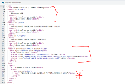

I have a dropdown with 3 options. When I select one of the option, the value should be in the token and passed to a base search. However, on the panel that uses this base search, the input never appears to be understood:
Here is the XML code for the dropdown and base search and panel:
Can you please help?
Many thanks,
Patrick
gcusello
Hi @POR160893,
generally when you use a baseSearch, you have to put at the end of the base search all the fields you want to use in the panels, but I suppose that in your case the problem is tha you're not using the base search, so you should try to use $dropdown_TOK$ in the searches withou using base search, in other words:

POR160893
Builder
Perfect, this now works 😀.
