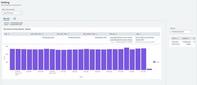

Okay @datachacha
Ive been having a good think about this and I dont think I have an elegant solution - but I think I do have *a* solution:
This uses a hidden token/text box to the side and a search to determine the _time+2hours.
You can then use this in your other queries as earliest/latest as per the sample event on the dashboard using `$globalTimeSpl:results.earliest$` and `$globalTimeSpl:results.latest$`
Here is the full JSON to have a play around with - does this do what you need?

datachacha
Thank you for the timely response. I tried what you recommended and ran into a few issues that I was not able to diagnose or fix with the troubleshooting tips provided.
I got everything looking exactly as you said. However, $result._time$ doesn't seem to evaluate to a time whatsoever; when I check the value, it is literally just "$result._time$".  The latest time value gets set to "relative_time(-7d@h", which appears incomplete as shown.
I get an error on the visualization saying Invalid earliest_time, and both earliest and latest show invalid values.
When I tried to put in the troubleshooting eval command you recommended, it did not fix the issue. The time should be coming in correctly.
