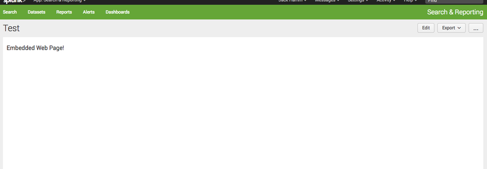

I'm having trouble getting this working in 6.5.0. I used this exact snippet from another question about iframes where they did get it working:
<dashboard>
  <label>Test</label>
    <row>
     <html>
     <h2>Embedded Web Page!</h2>
        <iframe src="http://www.splunk.com" width="100%" height="300" style="border:none;">></iframe>
     </html>
   </row>
</dashboard>
But what I see is:
Any thoughts on why the iframe wouldn't be displaying?

The problem that you are having is that recently Splunk has added some settings to control this type of content and defaulted dashboard_html_allow_embeddable_content to false. In order to get it to work, try enabling these settings in web.conf:

I was having the same issue and I opened a support ticket with Splunk. iframe does work in 6.5.x but in the example (which has an extra ">") it is using http://www.splunk.com in which Splunk's support informed me prevents anyone from embedding their website inside an iframe (google does the same as well). There is a useful site to help see if a site allows being embedded in an iframe (which is related to "X-Frame-Options" header but apparently not the only way to stop it):
http://www.tinywebgallery.com/blog/advanced-iframe/free-iframe-checker
Try this code instead:
<dashboard>
  <row>
     <panel>
        <title>Test iframe</title>
        <html>
          <iframe src="https://www.cloudera.com" width="100%" height="300" style="border:none;"></iframe>
        </html>
      </panel>
  </row>
</dashboard>
