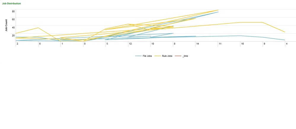

But for some reason it doesn't quite work. When I run the saved search using "loadjob" from the search bar in Splunk it looks correct. When I embed it in a Search module it mangles the series so that the X axis is no longer time but one of the field's output. This is my search module:

The $view_month$ param substitution works fine. The chart however is a mess... trying to include an image on this post...
sideview
See my answer for the more root-cause level answer. But here I think the loadjob problem may fall under loadjob's finickiness. Specifically it may be reordering the fields a bit. Are there still _time and _span fields? It Splunk's charting framework doesn't see both of those, then it will fall back from time axis to a plain categorical axis.
tsmithsplunk
That makes sense. I'll try to refactor my search to see if that helps. But if loadjob can't guarantee field order then I suppose my only choice is to switch over to real time searches and let the users wait. Thanks!
