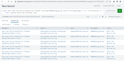

I have set alert for below query:
index= "abc" "ebnc event did not balanced for filename" sourcetype=600000304_gg_abs_dev source!="/var/log/messages" | rex "-\s+(?<Exception>.*)" | table Exception source host sourcetype _time
And I got below result:

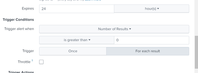

I have set the alert as below
And I have set the incident for it with SAHARA Forwarder but I am getting only 1 incident though the statistics was 6.
6 incidents should get created
And also Incidents are coming very late if  event triggered at 8:20 incident is coming on 9:16
Can someone guide me on it.
