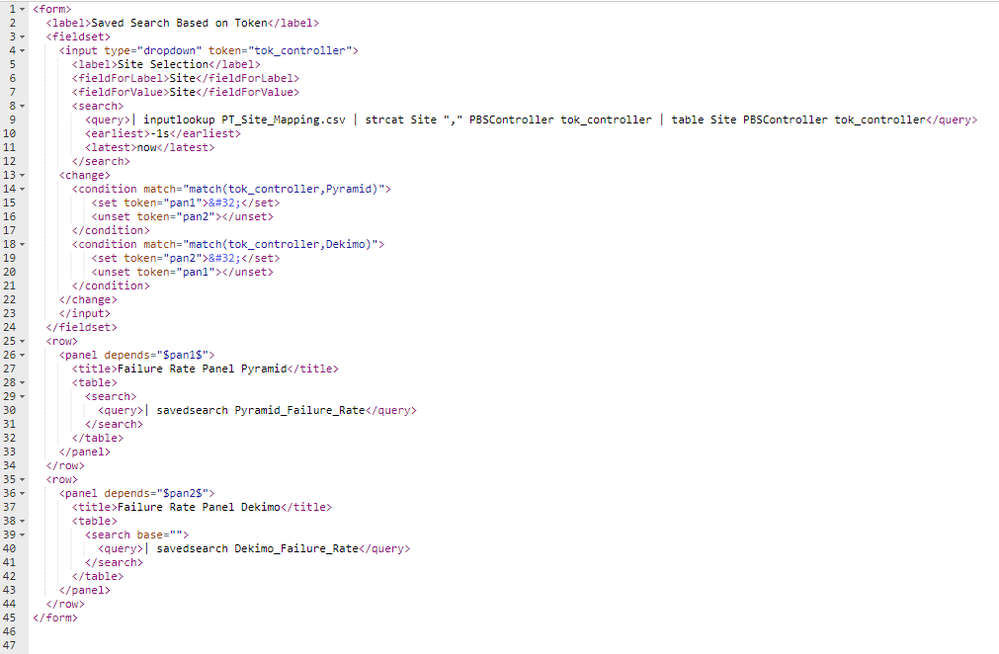

Thank you for the response. I think you've got me in the right direction. But the savedsearches are performed in the Panels.
I have two objectives:
(1) define two different tokens "Site" and "CONTROLLER" based on a single input. Both tokens are captured from the Site_Mapping.csv file. There are multiple sites but only two types of controllers. For example, a user selects their respective site name which has one of two different controllers.
(2) perform a savedsearch in a Dashboard Panel based on those two tokens, specifically the controller token. For example, the controller type is "Dekimo" will use: <query> | savedsearch Dekimo_Failure_Rate_Per_Day host="$host$" </query>whereas if the controller type is Pyramid will use: <query> | savedsearch Pyramid_Failure_Rate_Per_Day host="$host$" </query>
Your help is much appreciated.
like2splunk
Sorry - I meant to put "Site" instead of "host" in the sample code.

Well the issue is that I need many different panels which each have a different savedsearch.
I figured out conditional panels here: https://answers.splunk.com/answers/598064/if-else-condition-for-dashboard.html
But what I need now is how to get multiple tokens from the same dropdown input.
Any ideas??

like2splunk
@niketnilay
I want a dashboard that has one dropdown input. Based on that input selection, multiple panels (line charts, tables, pie charts, etc.) will populate with data.
The various input options are pulled from a CSV file containing the site names.
The input should be called "Site" and the token will be $host$.
The CSV file also contains a "controller_type" for each Site; each Site has either a "Pyramid" or a "Dekimo" controller.
Each panel will then call on a unique savedsearch (e.g. Reports) based on whether the Site has Pyramid or Dekimo controller.
There are multiple savedsearches for each type of controller.
I need to be able to define two different tokens from the CSV file.
