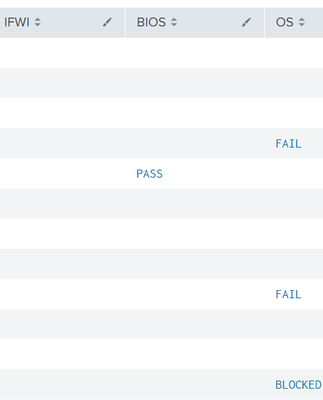

I want to remove the null values, which are in empty cells, there is no data present I tried multiple ways not able to remove them,
index="gitxapixation" platform !=null provision_type IN (*) site_location IN (*)

I will appreciate on this, please help me out

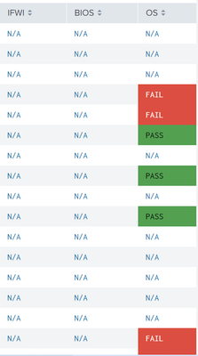

Each row represents an event from your results. Each column represents the fields for those events and their values.
If you want something in those fields to represent the fact that no value is available for the field for that event, you can use the fillnull command, for example:
| fillnull value="N/A"

Is there any logic can we hide or delete, all 3cloums having N/A values, because there is no data present.
ITWhisperer
Unless you have create the fields with null for all events, there is likely to be at least one event with a non-null value, although it may not be on that page of the table, therefore the column remains.
If this isn't the case, you would need to share your search so we might be able to find a reason for the "empty" columns

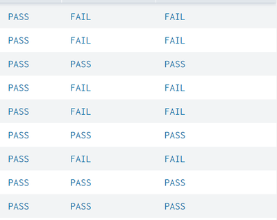

Great Thanks, @ITWhisperer Its working fine but
Is there any chance actually i want like this
ITWhisperer
Seems unlikely given that your stats are by WW Platform Kit and AutomationType. You could either fill in the blanks (use fillnull as previously mentioned) or exclude all lines where any of them are null.
What do you think a table like you showed would represent?
ramkyreddy
the output actually I need in the 2 Fig.
Thanks a lot, @ITWhisperer for helping me out with this query its working fine
