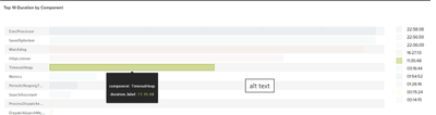

Ananya_23
Loves-to-Learn Lots
Didnt get u but This is the query which i built up so far which is capturing time difference in HH:MM:SS in stats view but i want to display the same duration in chart as well
index=music Job=*
| stats values(host) as Host values(Job) as Job, earliest(_time) as start_time latest(_time) as end values(x) as "File Name" by oid
| eval Duration=(end-start_time)
| eval end = strftime(end,"%m-%d-%Y %H:%M:%S")
| eval start_time = strftime(start_time,"%m-%d-%Y %H:%M:%S")
| rename opid as OPID, start_time as "Start Time", end as "End Time"
| chart list(Duration) as Duration by "Start Time"
| fieldformat Duration=tostring(round(Duration, 0), "Duration")
Current stats output:
i want to display like this
