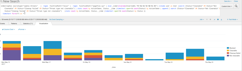

Here is what the dashboard panel looks like. alt text
Here is what I get when I search. (via the dashboard panel)
I am sure its something simple I am missing. Thanks in advance

The issue I ran into, without the append I would only get one column, like this.
index=sophos sourcetype="sophos:threats" | regex FullFilePath!="eicar" | regex FullFilePath!="pagefile.sys" | eval _time=strptime(InsertedAt,"%Y-%m-%d %H:%M:%S.%N") |rename user as User |search (Status="Cleanable" OR Status="Not Cleanable" OR Status="Cleanup failed" OR Status="Threat type not cleanable") | stats count by ActionTaken, Status, _time |timechart span=1d count(Status) by ActionTaken
Adding the append gives me this.
Since this is my first time trying the base search option, I am completely open to suggestions and other options.
I will adjust my searches with your suggestions, thank you for them.
Edit. The other reason for the second search was to add the action, looking to see how many were blocked.
