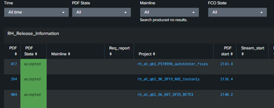

1. how to change source for only one column in a table and filter/sort it based on other column?
Below i need to change source for mainline column and associate data to project column. also i need to filter and sort the data alphabetically.
 <table>
<search>
<query>index="wtqlty" source=pdf-fc-002-rh sourcetype="release_pdf_results_json" | table pdf_name, pdf_state, main_line, Req_report, patch_name, started_on, Stream_start, Handover, planned_stopped_on, fco_state, snapshot, stakeholders.project_leader.name, stakeholders.developer.name, air_issues{}.short_description , Quality, questionnaire | rename pdf_name AS PDF, pdf_state AS "PDF State", main_line AS "Mainline", patch_name AS Project, started_on AS "PDF start", planned_stopped_on AS "Planned Stop", fco_state AS "FCO State", stakeholders.project_leader.name AS PL, stakeholders.developer.name AS Developer, air_issues{}.short_description AS Description, questionnaire AS Questionnaire</query>

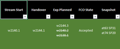

3. how can we strike a number based in cell and update with new number(in case of weeks)

  1. The table will show the results of a search query, so construct the search query to have the data from both sources, perhaps using a join or stats command to collate the events from the different sources into events with common field values
  2. Use the drilldown method shown in the response to your previous question
  3. You can use some CSS to line-through multi-value lines
    <panel depends="$stayhidden$">
      <html>
        <style>
          #id-of-panel div.multivalue-subcell {
            text-decoration: line-through !important;
          #id-of-panel div.multivalue-subcell[data-mv-index="0"] {
            text-decoration: none !important;
        </style>
      </html>
    </panel>
