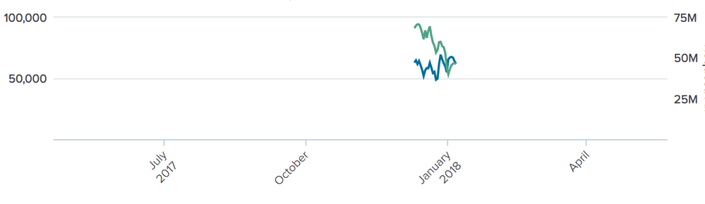

After I upgraded to v7.1, I found some charts in some dashboards are showing incorrect result. I have captured two images to explain what I mean. (same problem in 7.1.1)
Image 1 - During drawing: the chart shows these two lines segments (note: the plotted values are correct) while the dashboard is busy generating all the other data.
Image 2 - Finish drawing: After all other data points are available, we can see that the scales on the Y-axis has changed (look at those scales in Image 1), and most data points were plotted correctly. However, those data points shown in the Image 1 stayed in their old positions. They should be adjusted based on the new Y-axis scales but they weren't!
Refreshing the chart inside the dashboard didn't help. If I plot this same chart separately (as a separate search in a new search window), then it displays correctly. Please note that I have double checked the value in tabular format. In tabular format, the values for those data points in Image 1 are correct, but they're positioned incorrectly in the image 2 (their "plotted values" in image 2 are doubled, wrongly).
I didn't remember seeing this problem in 7.0.x. And right after we upgraded to 7.1 and this problem was reported by a user who looked at this dashboard daily. So I think it's introduced by 7.1.

@patng_nw does the issue also occur when the number or results plotted are less? I mean could this be performance related as you have millions of events plotted across your chart? I wish I could help but I have not been able to recreate the issue! Keep working with Support hopefully they figure it out soon enough!
niketn
Legend
@patng_nw, I would think the chart plotted is correct. You seem to have two series Counter1 and Counter2 and Counter2 is setup as Overlay Field with View As Axis option turned on. This makes upto ~150M count on Counter2 plotted in the same chart with equivalent Counter1 upto ~200000 (I would prefer Number Abbreviation turned on for Y-axis as well just for consistency).
You can turn off View as axis to see original count of both Counters on single y-axis. However, I feel the graph is correct, considering you are using overlay. Also validate the Data in Tabular format to double check.

@niketnilay As I explained above, the chart plots correctly if I plot it just by itself (instead of as part of dashboard), and I have already double checked the actual values in tabular format. Therefore the chart is incorrect.
