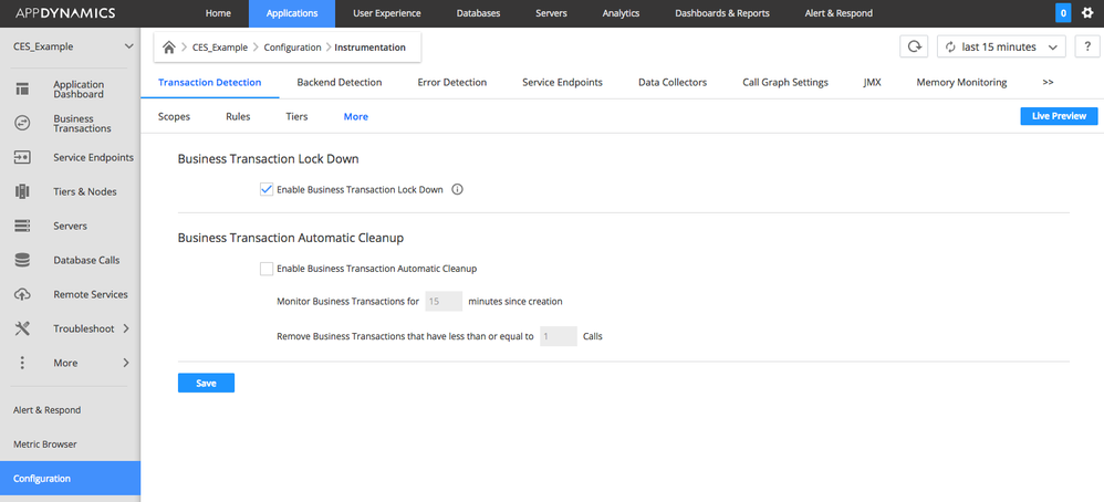

Business Transaction Lockdown
If you'd rather not use a catch-all BT, try enabling the "Business Transaction Lockdown" checkbox. This feature prevents any new BTs from being created by default. Having this set prevents unexpected BTs from exceeding the thresholds, and prevents any new BTs from being created by default. To find this feature, select Configuration > Instrumentation.  If you are using a 4.2.x version of the Controller, select the Application level within the tiers/nodes list and then check the checkbox.   If you are using a 4.3.x version of the Controller, select the "More" option.   In either case, remember that BT Lockdown applies at the Application Level.
image.pngSelect Configuration, then Instrumentation, then More
When you enable this feature, any new URLs that don't match an existing rule will be sent to the "AllOtherTraffic" container directly, regardless of the current state of BTs and their thresholds.
