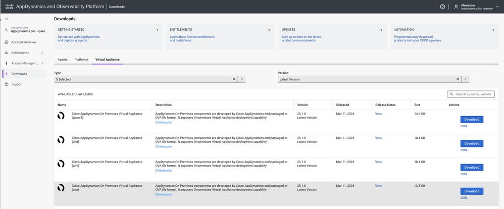

Step 1 – Download the Virtual Appliance
Visit AppDynamics Downloads portal to get the Agents, AppDynamics Platform components, and Virtual Appliance. Ensure you download the correct type for your environment; for VMware, this is the OVA. The download includes everything you need and can be deployed in an air-gapped environment without further internet connectivity.

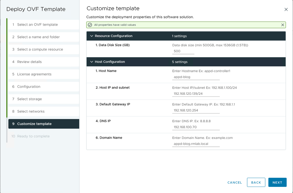

Step 2 – Install the Virtual Appliance through VMWare vSphere
Deploying the Virtual Appliance is like any virtual machine from an OVA template. Detailed instructions can be found in the documentation.
During deployment, enter the FQDN for the virtual appliance under step 6: Domain Name in the “Customize Template” section. The appliance requires DNS to function correctly; IP addresses alone are insufficient.
For air-gapped environments there is a workaround available using the nip.io wildcard dns resolution or modifying /etc/hosts files.
Important: Do not select to auto-start the VM after deployment; additional configuration is required before the first boot.
After a successful deployment only the VMware tools need to be enabled in the vApp Options.
This step, from deploying the OVA to configuring the settings, should take no more than 15 minutes.
