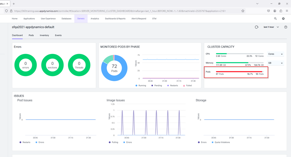

How do you get Cluster Capacity (pods)?
In the image below we see Cluster Capacity is being met.
How can I get ClusterCapacity?

abhibaj@ABHIBAJ-M-2KXL KubernetesInstallation % kubectl get nodes -o jsonpath='{.items[*].status.capacity.pods}' | tr -s ' ' '\n' | awk '{sum += $1} END {print sum}'
116
The same can be seen on the ClusterAgent page.
