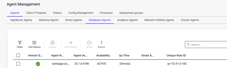

6. Validate Smart Agent in the Controller
  • In the Controller UI, go to Agents → Manage Agents → Smart Agents and look for your host name.
  • Once it appears, you can install a Database Agent on the same machine directly from the UI.

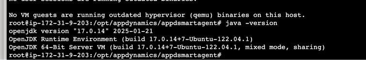

8. Using the Latest OpenJDK (Example: JDK 17)
  • If you need OpenJDK 17 on your Linux machine, for example, run as below:
    sudo apt update
    sudo apt install -y openjdk-17-jdk​
The Database Agent works fine with JDK 17 (tested on local machine IP address ip-172-31-9-203).

10.  Successfully Created MySQL Collector with the latest JDK 17 and Latest Database Agent version 25.1.0
