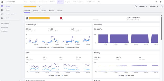

The administrator observes intermittent gaps from a Machine Agent installed on Windows OS. This can happen across single or multiple servers.
Gaps appear as follows:
