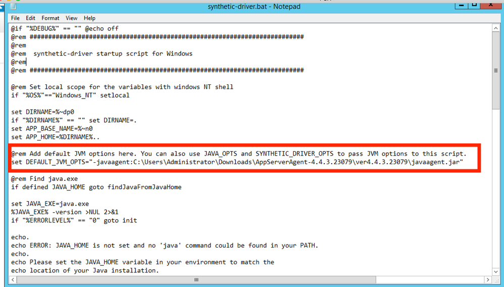

If you would like to instrument the Private Synthetic Agent for internal monitoring purposes, you can achieve it by using the steps below.
1. Locate the Synthetic-driver.bat file under the Private Synth Agent install folder and add the javagent.jar to the DEFAULT_JVM_OPTS as shown in the screenshot below

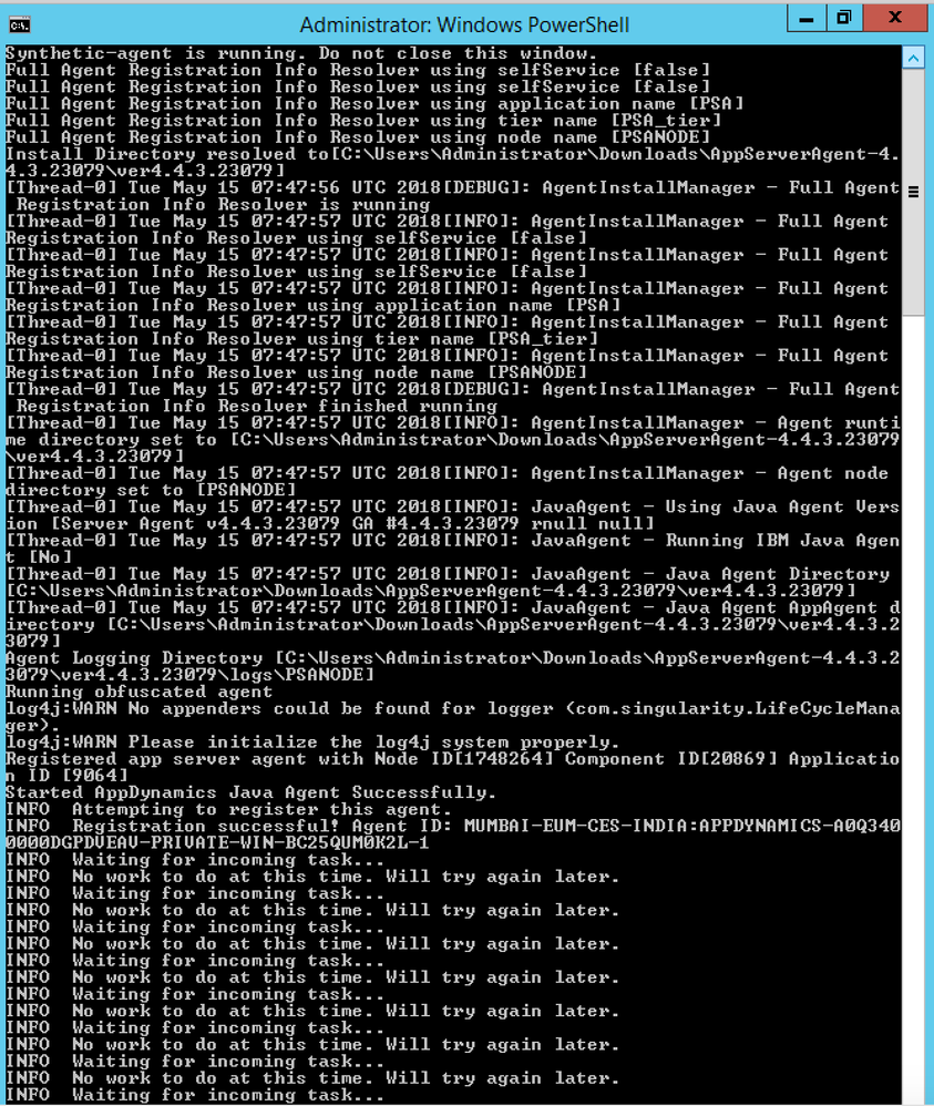

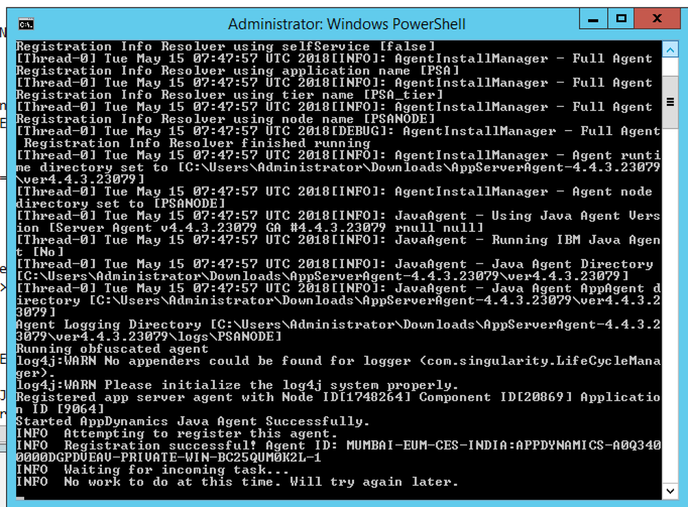

2. Save and restart the PSA, then verify if it registered successfully by looking for [Started Java Agent Successfully] in the console log.
image.pngAgent Registration Successfulimage.pngPSANODE
