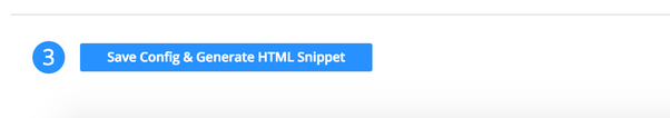

3. Select the option to "Configure JavaScript Agent" (see the screenshot above).
4. Select the "Advanced" option.
5. Scroll down slightly to add the following custom configuration.
(function(config){
    config.spa = {spa2:true};
})(window['adrum-config'] || (window['adrum-config'] = {}));
6.  Scroll down and click "Save Config & Generate HTML Snippet."
