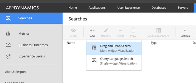

6. To make sure it's configured correctly, click the "Analytics" tab and create a new search. Make sure that you do not have any AdBlockers running in your browser, since this can prevent the screen from loading properly.
7. Even though you have no analytics data, you should see the screen below. If the screen hangs for a while after creating a search and you get a grey pop-up box indicating that you don’t have an Analytics Service setup, something is wrong and you'll need to recheck the values.

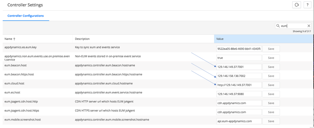

1. Log in to the admin controller.
2. Search for "key" in the top right.
3. Update the appdynamics.es.eum.key value with the EUM license key from "Install and Configure Step 7”:  9522ea05-88e6-4690-bb41-4340fbd6d233
4.  Make sure to update the EUM cloud host and beacon values with your on-prem EUM server.
5. Make note of the key: appdynamics.on.premise.event.service.key value for future use. In this example, it’s 7e3195ae-bf2f-4150-9ec6-2b379f3fc17e.

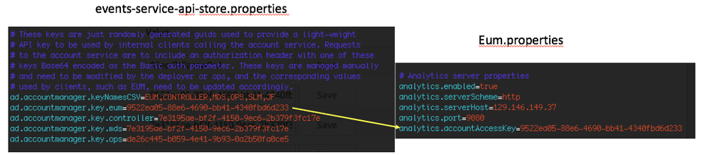

6. Open the file events-service-api-store.properties which is under /opt/appdynamics/events-service/processor/conf
7. Update the keys in the file:
  • Replace ad.accountmanager.key.eum with the key from step 3 (9522ea05-88e6-4690-bb41-4340fbd6d233).
  • Replace ad.accountmanager.key.controller and ad.accountmanager.key.mds with the appdynamics.on.premise.event.service.key value from the previous step.
Here is a key mapping guide! For a closer look, click on the image and expand it to full screen.
The sample events-service-api-store.properties key values would be the following:
ad.accountmanager.keyNamesCSV=EUM,CONTROLLER,MDS,OPS,SLM,JF
ad.accountmanager.key.eum=9522ea05-88e6-4690-bb41-4340fbd6d233
ad.accountmanager.key.controller=7e3195ae-bf2f-4150-9ec6-2b379f3fc17e
ad.accountmanager.key.mds=7e3195ae-bf2f-4150-9ec6-2b379f3fc17e
ad.accountmanager.key.ops=de26c445-b059-4e41-9b93-0a2b50fa0ce5
8. Verify that these keys all match up.
