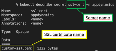

  1. Check if a Secret containing the certificate named "custom-ssl.pem" is created.

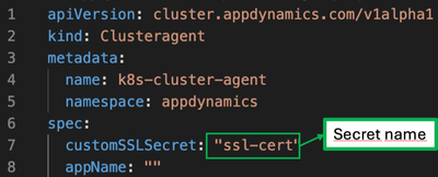

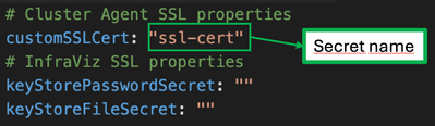

  2. Check if the Cluster Agent configuration file contains a parameter with the name of the Secret containing the certificate:
    1. "cluster-agent.yaml" -> Kubernetes CLI
    2. "values.yaml" -> Helm Chart

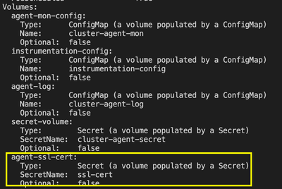

  3. Check if the Cluster Agent pod description contains:
    kubectl describe pod <cluster_agent_pod_name> -n appdynamics
    1. Environment variable "APPDYNAMICS_CUSTOM_SSL_SECRET: ssl-cert"
    2. Volume mount
    3. Volume "agent-ssl-cert"
