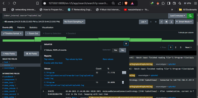

If you search "index=_internal source=*splunkd.log" - How many source do you see in the interested fields on the left? If the UF is sending then you should see 2.

If i search "index=_internal source=*splunkd.log" - I would see the 2  sources in the interested fields.
