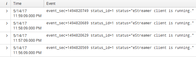

We have recently started facing some issues with the eStreamer client app on our Splunk indexer(CentOS). eStreamer starts with Splunk, makes the initial connection and logs flow for a minute or two. Then it just stops.
In Splunk, we only see client_check logs.
