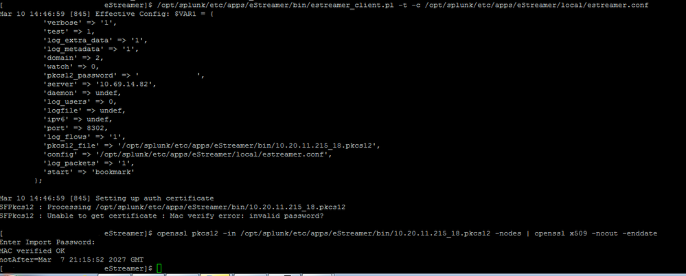

I've stumbled across an interesting error with eStreamer. It is returning that there is a invalid password which can not be the case. I've opened up the key being used in the eStreamer.conf file with the exact same password and it shows OK and the expiration date is OK. It is a new key and I have also tried updating the eStreamer app from 2.2.1 to 2.2.2 with still no luck. Any ideas?

Wanted to come back to post the fix for anyone else that may run into this issue in the future. The fix was related to a password issue in the configuration file. When I went back and checked on the password on the back end there was no single quotes around the password. Once this was changed our Splunk instance started receiving logs from eStreamer right away. Ex: 'your_password'

Thanks for the tip Matthew! This fixed my issue just now!

Wow! I wish I would have found this answer hours ago. I had to edit local/estreamer.conf to add the tick marks around the password... Maybe the app can be updated to do this automatically? I never would have figured that out.
