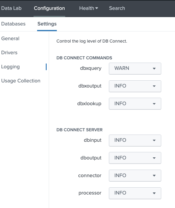

1. "ERROR ExecProcessor" is generated from splunkd, whereas "[metrics-logger-reporter-1-thread-1] INFO" is generated from DBX with log level INFO, this is by design.
2. Another workaround we can have is to setup the log level to WARN or ERROR, to eliminate DBX INFO logs through DBX UI

In my case this was resolved by clicking the Reset and Save buttons on the Configuration > Settings > Logging page in the DB Connect App and restarting Splunk.
The Reset button created and/or updated the following two files.
  • splunk_app_db_connect/bin/dbx2/rest/__pycache__/loglevel.cpython-37.pyc
  • splunk_app_db_connect/bin/__pycache__/dbx_rh_loglevel.cpython-37.pyc
The Save button created or updated the follwing files
  • splunk_app_db_connect/jars/server.vmopts
  • splunk_app_db_connect/jars/dbxquery.vmopts
  • splunk_app_db_connect/local/dbx_settings.conf
  • splunk_app_db_connect/metadata/local.meta
