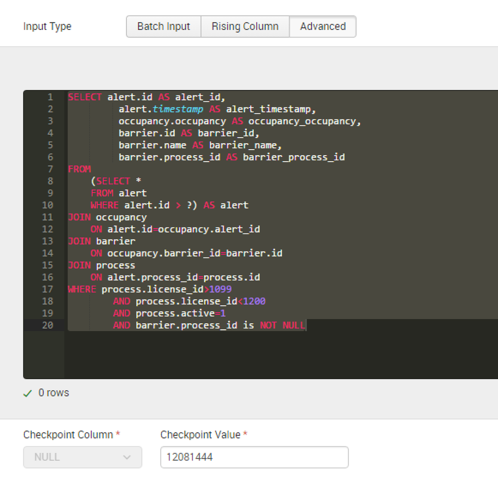

I am using an input in Splunk 6.4.3 and Splunk DB Connect 2.3, that makes use of Rising Column in Advanced mode for MySQL.
Indexing occurs correctly, and all goes well until it has finished parsing data and no new data is available.
This occurs on all my inputs (9) and makes my MySQL go up to 90% CPU usage without motive.
When indexing, if I do a show full processlist, it shows search being performed with the rising column value.
But after it has finished the initial index, every time it has to run (specified by interval value set to 60), I notice CPU goes up and my show full processlist indicates that my rising column value is empty: ''.

And show process list query is:
SELECT alert.id AS alert_id,
         alert.timestamp AS alert_timestamp,
         occupancy.occupancy AS occupancy_occupancy,
         barrier.id AS barrier_id,
         barrier.name AS barrier_name,
         barrier.process_id AS barrier_process_id
FROM
    (SELECT *
    FROM alert
    WHERE alert.id > '') AS alert
JOIN occupancy
    ON alert.id=occupancy.alert_id
JOIN barrier
    ON occupancy.barrier_id=barrier.id
JOIN process
    ON alert.process_id=process.id
WHERE process.license_id>1099
        AND process.license_id<1200
        AND process.active=1
        AND barrier.process_id is NOT NULL
As there are many results, searching without taking into account rising column for:
 (SELECT *
    FROM alert
results in unnecessary CPU cycles that should take less than 300ms and take 30 seconds or more.

However, in attached image, I do see that if last column value is reached, it shows raising column as NULL. Is that normal?
The fact that 9 dbinputs do a full scan make my PC have a high CPU usage.
