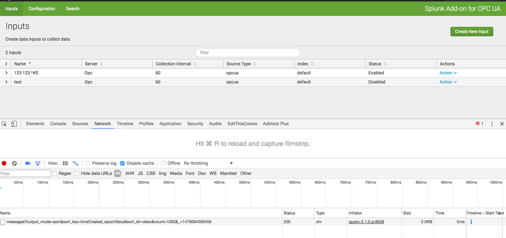

It will be very help for if you can share the error messages of ajax calls:
Browser's Dev tool is very useful for this case, Chrome for example:
Open Dev tool, and go to the network tab.

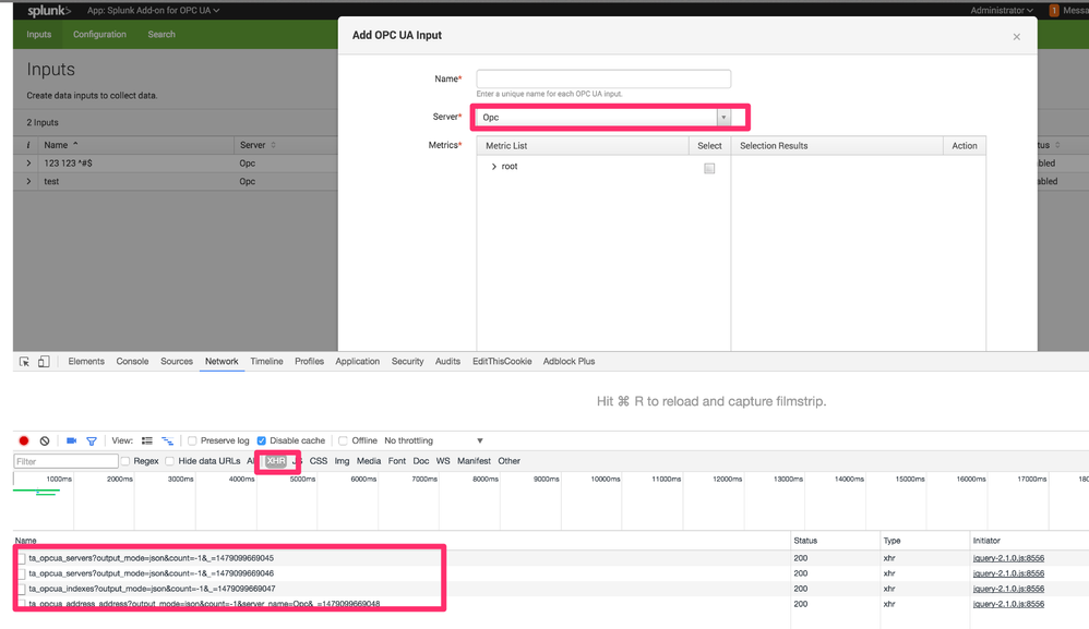

Open the "Create New Input" and select the server:
If there is any, click the item will show the whole description 🙂

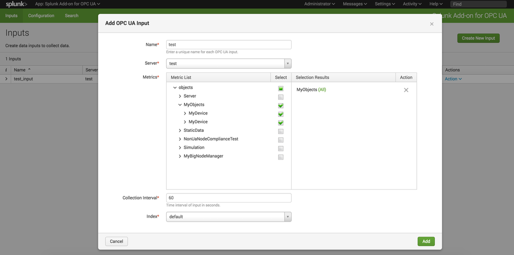

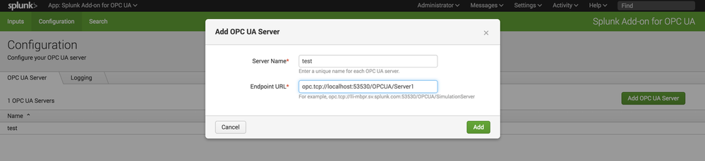

Hi @ggeihs03, in new version you don't have to enter read nodes manually, you should go to OpcUA configuration page from Splunk launcher first and then add new OpcUA server in configuration page (you should specify a concrete OpcUA endpoint, e.g. opc.tcp://localhost:53530/OPCUA/SimulationServer), after adding new OpcUA server then go to inputs page and add a new input select read nodes from metric tree.
  1. config OpcUA server
  2. config input
