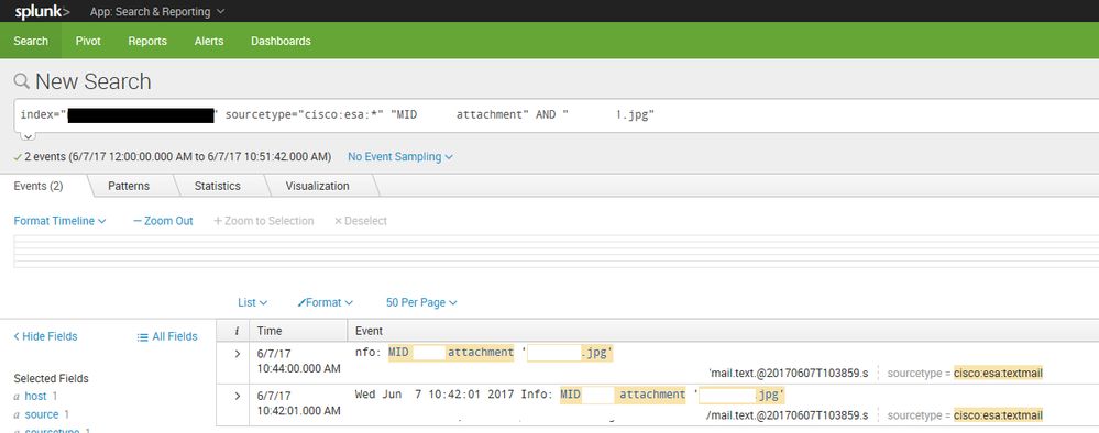

Below is a screenshot of search finding one event, that gets mangled and duplicated (using the suggestion break before regex). Checking the file, there is only one event on one line, no idea why splunk is doing this.

When I uploaded to the dev box, it works fine. I think you're on to something with the ESA uploading via scp several files and splunk ingesting them in near real-time. I used time_before_close=120 and it didn't do anything.
I just had a short file come in while tailing, about 10 lines that splunk mangled twice. The tail -f command showed the file as it is on the filesystem (correctly), so me tailing the file isn't showing a problem.
What is odd is, the WSA (same Cisco appliance OS) sends the logs over in a similar fashion and doesn't have this problem at all (we've had this running for years now). Not sure why now it is all of a sudden a problem.
